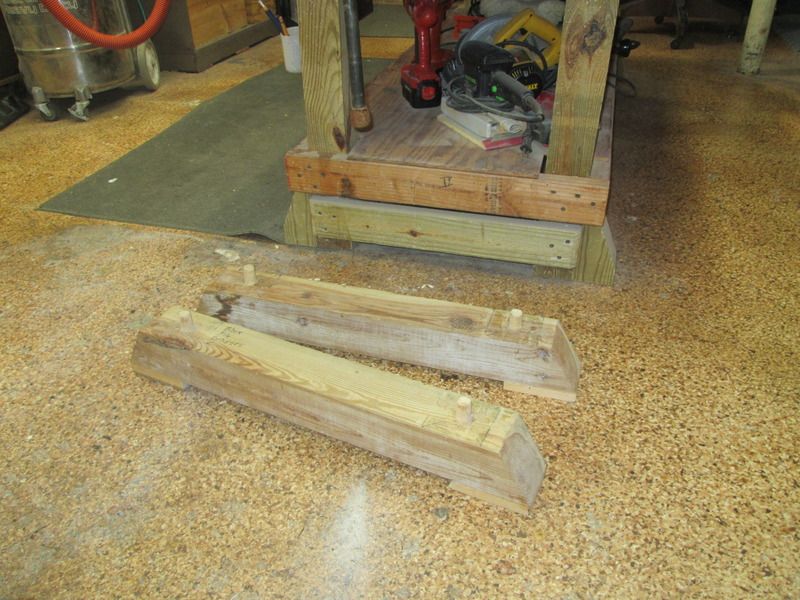

I've been trying to adapt the best method in my work space for more years than I can count.  The main work bench can't be moved so I raise and lower it with 6 x 6's  and the combination of a piano like stool that I can raise and lower myself.  The bench is 7 feet x 42 inch and over 800 lbs - one day I can be covering a chair seat at 40 inches high and the next day heavy hammering of plywood together at 30 inches.  I could never do any serious building on a scissor like table because it would be unsteady. Also have saw horses and a 25 inch rolling table that's 50 inches x 40 inches.  The combo of all the props gets me through
